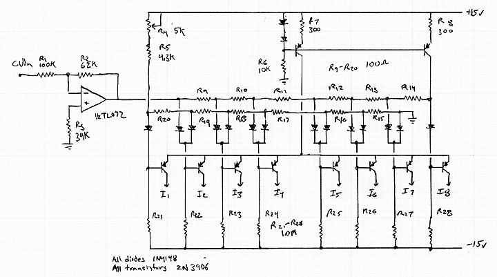

I think I'm going to build the Tillman IS, but I have some questions:
Is a LM13700 a good replacement for the CA3280?
If so, is the 'Id' input of the CA3280 equivalent to the 'diode bias' input of the LM13700?
In J. Donald Tillmans I.S. from January 1999 the 'input sections' are 'mixed' into a voltage follower. Is it really possible to do that? I mean each 'pan' overlap each other a little.
I would prob have used a regular non-inverting mixer with a resistor in between each 'section'...

PostPosted: Tue Jan 01, 2008 2:03 am    Post subject: Reply with quote  Mark this post and the followings unread
Hi Pier
The inputs of the CA3280 are a bit different from these of the LM13700. I may be wrong cause I don't have the datasheets at hand but the CA3280 has current inputs while the LM13700 has voltage inputs. This means that for the LM13700 you must add some resistors (say 100/220 ohm or so) between the inputs and the ground. In your schemo, add a 220 ohm resistor between the non-inverting input and ground. I don't think it is necessary to add one for the inverting input because the offset trimmer is already providing a polarization.
The Id pin is for the linearizing diodes.

say i'd liked to build a four channel version, could i just leave off four of the control current sources (edit: diodes/transistors) and double the value of the resistors R9-R20 or R21-28 (or what resistors would remain then)?

maybe my question was not understandable, because i simply don't understand how that circuit works!?
2nd try:
i'd thought the incoming voltage was somehow divided by the resistors R9-R20?
so for a four channel version, would it be appropriate to leave off just the diodes and transistors of the needless channels, while keeping all resistors R9-R20?

PostPosted: Wed Jan 02, 2008 5:17 am    Post subject: Reply with quote  Mark this post and the followings unread
I'd try this (and tweaking some resistor values, probably). Not garanteed though Wink
Modified schematic (I removed R18 as well ;-) )

thank you very much. so it's the ratio of these resistors (R9-R14 or R15-R20) to the sum of their values that creates the division!? so if i changed just one of these resistors i would widen/narrow the according window?
R18 should be removed as well, maybe.

PostPosted: Wed Jan 02, 2008 5:34 am    Post subject: Reply with quote  Mark this post and the followings unread
fonik wrote:
nice work, yves Very Happy looks great.
good breadboard application for me, i guess.
Yes, the ratios between the values of the divider resistors set the operating range of each channel.
You're right about R18, it must be removed...
